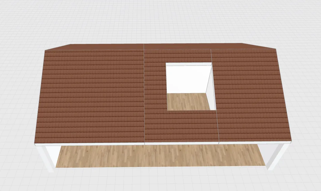

It seems like there is a need for a tutorial on how to make a Skylight. Maybe you know how to do it, horray! But for a whole lot of us that don't know how to do it- we search Google and YouTube but can't seem to find it!
This is a simple way to make a Skylight using Roofing Structure.
I made a 4 videos how how I do it, hopefully it helps, and if you have an easier way to do it- please do share it with others! :)
) One Skyligh: https://www.awesomescreenshot.com/video/42769234?key=6169ed746c1f96fb4b14f218977726ab
) Two Skylights: https://www.awesomescreenshot.com/video/42769351?key=23b88d07f51781a90da2e6c8869f2801
) Advanced- Skylight with ceiling: This needs Customized > Interior Modelling https://www.awesomescreenshot.com/video/42770145?key=54df00a19fbd257ba6c3a2545ae5a96e AND https://www.awesomescreenshot.com/video/42770288?key=42bd47d9597d77383596c671a00e750c
