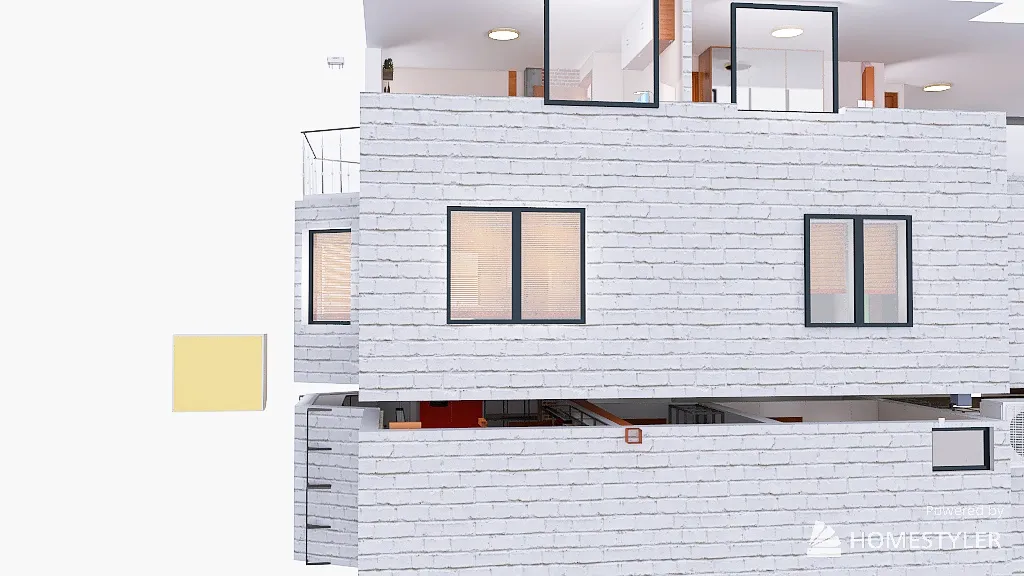

Hi, Could someone explain me, how to close the gap betweem basement and the 1th floor. I don't know how it happened and when, and I can't come back to previous good version. Mabe there's an option to moove whole floor up and down, ore something, but I don't know how. Regards

Hi, I had the same problem. If you go the the floor above you, try reducing floor height. Or of your are too lazy (like me) then use the material brush and color the gap the same as the wall above.

Hi, you either have to add an actual floor to the second floor or check the "Floor Thickness" (by default it's like 20 or 30 cm) - this setting appear when you click anywhere outside your walls (so you do not have anything selected)

had the same problem. solution is: select the ground floor, then check the "floor settings" (by clicking outside an empty space) and check whether the wall height of the floor is bigger than your wall height on the first floor.

I've gave up. I've come back to one of the previous version and started again form there :(
