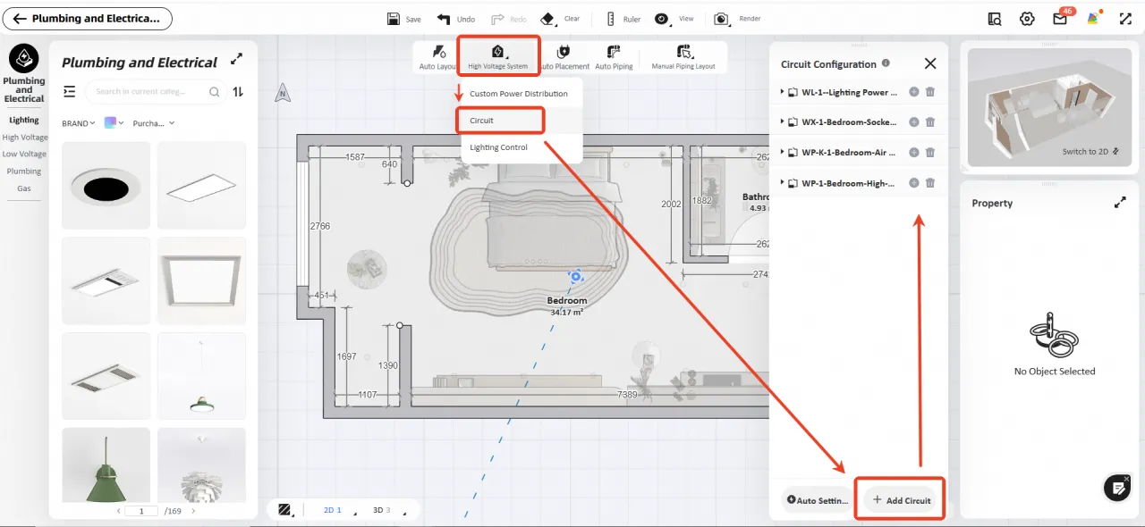

Before adding, ensure you have all relevant furniture, switches, electrical components, and water outlets ready.
And users need to first go to the circuit, add at least one lighting circuit, and then include switches and fixtures within it.
1.Select “Manual Piping Layout” and choose the pipe to add (e.g., High Voltage Pipe). (Switch to 2D view for convenience; shortcut key is 1.)
2.A green outline indicates where you can draw.
3.Hover the pencil over a socket/switch to change the outline to blue, then draw. Connect two points to generate a circuit. Press “Esc” to exit the command.
